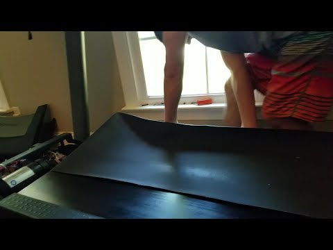

  • can you give me some standard treadmills to consider that I can take the deck and belt out fairly easily? Like the Proform 995 C in this video, I can just open up the panel on one side to take them out. Anything basic treadmills like that around the $500 range? Thanks
  • Just about every treadmill out there will be the same way. There are only a few odd ones that require any more than this
