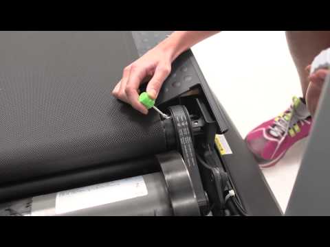

  • The belt look fine, make sure when you lube the belt ,you apply lube under the belt onto the deck surface closes to the middle of the surface as you can. Also you can do a test and see if the drive belt is slipping or pulley has broken loose on front roller.sending over attachments so you can look at them.

    I've attached a video of what happens when I run on the treadmill,
    it looks the front roller and motor also stops or gets interrupted.
    I guess that means it could be the controller or a motor problem ?
    Could a too tight belt also cause this?
    Could you please check the video and guide me with further steps to exclude either the motor or controller as faulty item ?
